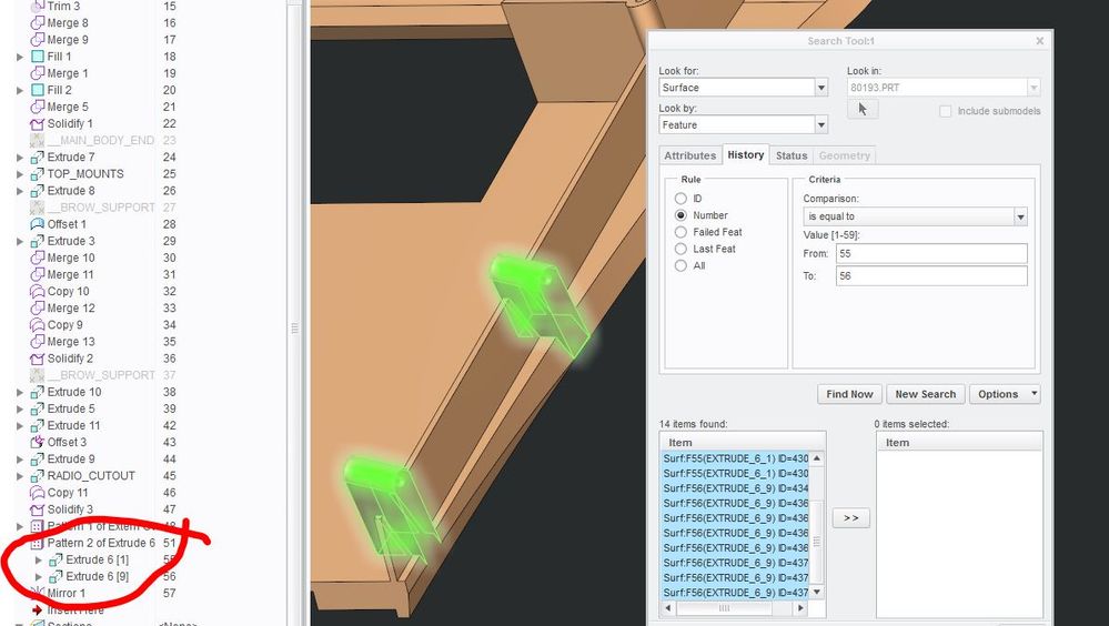

You can use the find tool to do this.
Set the following:
  • Look for surface
  • Look by feature
  • On the History tab, select number
  • Set the number range for the features that you want
  • Click find now and all the surfaces of those features will be found
  • Select the ones you want, click the >> button to add them to the selection
  • Choose the color you want

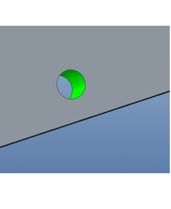

One trick is to color the solid one color, then change the surfaces to another color. When you do a hole or other cut operation, the solid color will be where the cut is.
Set the following:
  • Look for surface
  • Look by feature

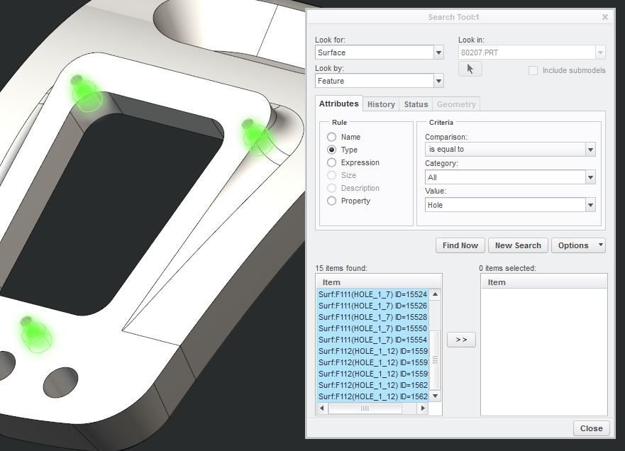

You can also find surfaces of features of a certain type.
For all hole features use the Attributes tab like this:
