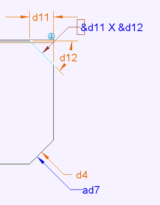

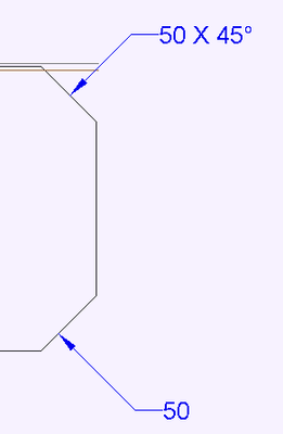

With respect to imported models, if you are trying to detail them in creo, you will need to create all your dimensions from within the drawing, for example, a chamfer, I would use a note with a leader. Detailing a drawing of an imported model will be a very tedious process, not something I would enjoy doing but sometimes necessary.
You can create the dimension wanted in a couple of steps.
To copy dimension into drawing note add '&' before dimension name. Name can be found by hovering mouse over dimension or by selecting Switch Dimensions button.
