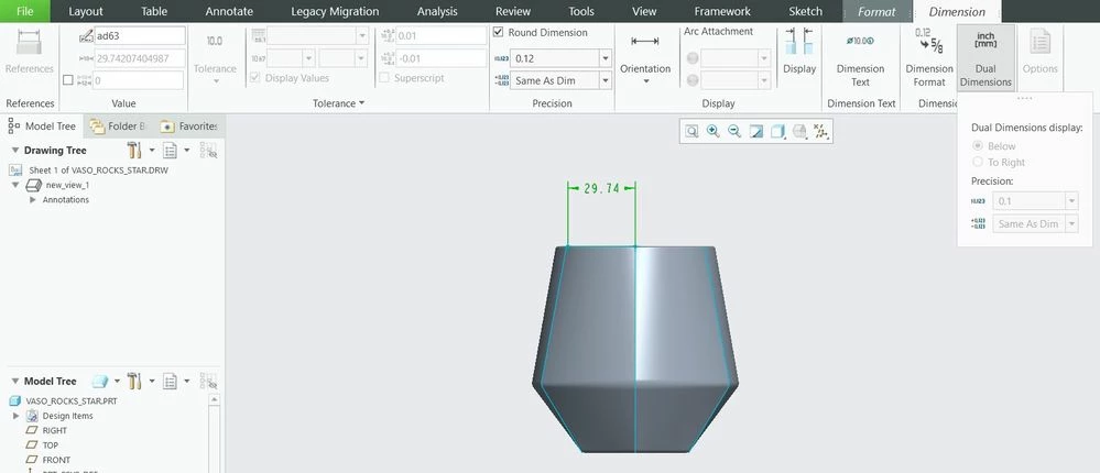

When I open a Drawing file in Creo Parametric 8, it won't let me put either tolerances or dual dimensions on the dimensions I place. Please help meeee, how can I activate those functions?

Verify that the following detail options are set as explained in the links below.
To Format Existing Dual Dimensions in a Drawing (ptc.com)
Setting the Tolerance Display (ptc.com)
