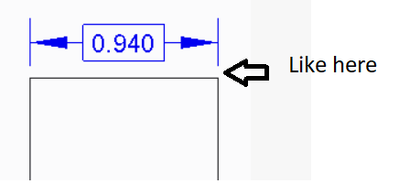

How to automatically create gap between witness line and part line as shown in the below picture.
Solved! Go to Solution.
please read https://www.creosite.com/cgi-bin/find_option.cgi?srch=witness_line_offset&ver=creo1&mode=drwsetup page.
