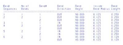

I would like to change the bend_order table note information in the drawing. Is it possible?
One possible quick workaround would be to edit the .bot table. If you are able to open the <partname>.bot file in a text editor, then you can edit it to fit your requirements. You can save this in a .txt file and then import the note from file to use in a model annotation or drawing note.

A bend order table is constructed by fully unbending a part and recording the bend back process. Have you attempted to re-record the bend back order? If you did this, are you finding that the annotation is not updating to the newly recorded bend order?

I already created the bend_order feature. I would like the drawing annotation to show the following information: bend sequence, bend ID, bend angle, bend direction. I would like the other information not to appear. The system default does not suit me.

Hi @Victor_Brumatto ,
With current limitations in Creo Parametric, suggested workaround "about editing partname.bot" can be the solution.
