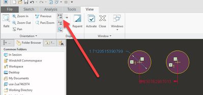

How would I add a dimension that shows the distance between the center of two circles?
I have a screen shot of what i'm working in.
May 22, 2019
It's odd that you don't already have "weak" dimensions that are automatically created, maybe your dimensions are turned off. Go to the VIEW tab, then make sure dimensions are toggled on.
In the SKETCH tab, select DIMENSION and pick one circle, then hold ctrl and pick the other. Place the dimension with the middle mouse button.
