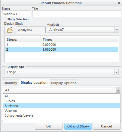

When post processing it is sometimes useful to pick just a surface, for example, to view vectors on.
If that surface is on a component buried in an assembly then one could look at just that component.
But perhaps only one surface is required. Or perhaps a capping plane is desired using 3 points that are vertices on a component.
Creo then presents the entire assembly in a new window and one has to 'click through' (struggle) to find the desired geometry.
Very awkward.
The fudge, (English for work-around but also a kind of soft toffee often purchased when on holiday at the seaside), for hiding the datum features is to move the PP window to one side and access the view menu in parametric where the datum features can be turned on/off (the in window tool bar won't work for this)
But how does one hide components to de-clutter the assembly such that the relevant geometry can be easily selected?
