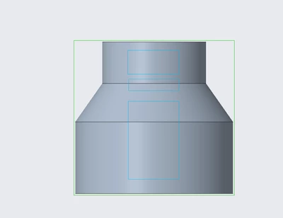

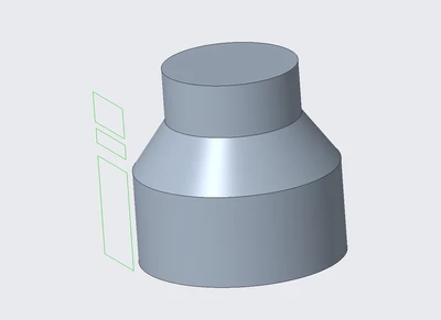

Hi all,
In the image below, I would like to project the sketch onto the revolve. I would like to project onto all of its surfaces at one time, if possible. Please note that the sketch overlaps between different surfaces. Preferably, I'd like to do this such that I could even extrude/offset the sketch from the surface.
Anybody have any suggestions? Thank you in advance!

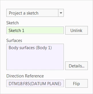

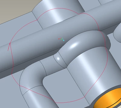

Best answer by tbraxton
One option is to select body surfaces (if you are in Creo 7+).
Circle sketch projected onto a body
tbraxton
tbraxton22-Sapphire IIAnswer
August 12, 2022

August 15, 2022
For the offset/extrude part of the question I would suggest using Offset > Expand > Sketched Region.
