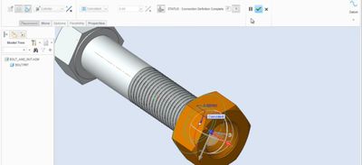

Screenshot_20200628-144521_YouTube.jpgAs soon as we apply I cylinder joint in assembly a rotation  direction is is start showing. How can we specify the direction like clockwise and anticlockwise or change the default rotation direction.
I think I understand what you're asking...
When the angle is not in the clockwise/counterclockwise direction I want, I just enter a negative value for the angle, and it changes the "default" direction. I believe the initial angle is oriented with respect to the normal vector of the geometry being used to define it.

Thanks a lot for the reply. I was doing the same in my assembly but for some reason, it was not working. Then I again set up the assembly and my problem solved.  With your reply, I understood that I was doing the correct thing and arranged the assembly again and problem solved.
I will share some work here later. Well, thanks a lot again for the reply.
Here is the video where I was trying to create a bolt and nut animation. And nut was rotating in the wrong direction.  After filling the angle with the negative value the problem solved.
