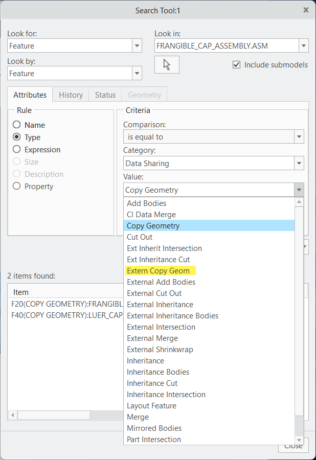

Since you mention a search for external copy geometry features are you certain that you created an external copy geom in assembly mode? Your description does not explicitly explain if you used the external option when in assembly mode. Try using both filter criteria and you will see a difference in the results returned.
The search tool includes both copy geom and external copy geom filters as shown below.
