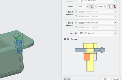

IFX - 2D preview and 3D preview does not show correct representation of Screw/bolt.
  • April 16, 2024
  • 2400 views
I'm using IFX to create my own custom library.
I've added a few hardware components. Everything is operating OK, but when I use IFX, I do not get the accurate representation of Screw in 2D and 3D previews.
Images are included here.
Please let me know if anyone knows how to fix this.
I did not find anything related to apperances settings in help section.
With custom lib -
With Default Library

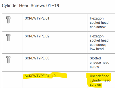

Best answer by OliverGräbner
IFX only has previews for the predefined types.
If you have a type, which is not available, you can use type 99.
For this type only the maximum outline will be shown.
Together with your own screw icon you will have a good preview.
Hope this will help.
April 16, 2024
you will find an image with all required dimesions to paint the 2D/3D preveiw correctly.
Here an example for SCREWTYPE 01
Image: SCREWTYPE 01 (ptc.com)
In addition you will find a folder for each type inside the ifx installation folder:
C:\Program Files\PTC\Creo 10.0.4.0\Common Files\ifx\parts\ifx_fastener_templates\screws\screw_01
Allways make sure, that the columns listed inside the *.dat template file are also available in your customized file.
If there are any concerns, please upload your bolts.dat file and I will have a look at it.

I am looking for some custom representation here like below image ,
I checked to use custom screw using Screw type 50 , also created prt file and template for Screwtype 50 ( attached here, just remove .txt extension). But I guess Creo does not allow custom views like above image and only allow standard Hex head/round head views.
April 17, 2024
