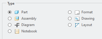

You can assemble B.asm into C.asm as you would normally do. As long as you don't edit definition of any components of B, the relative positions between the components of B will remain, i.e., if you edit definition of B.asm, all the components will move together.
I think what you want to do is to avoid accidentally edit definition of one of B's components. One way to do that is to export B.asm as a step file, then import it as a part.
In the screen appeared when you import step file, select "Part" as the screenshot above.
Then B will become a part.
I don't know why but sometimes the relative position of parts in B may not be the same as it was. Maybe someone in this forum knows.
If you just want to "freeze" B.asm and then "unfreeze" it and work with B, currently I don't know any method to do so.
