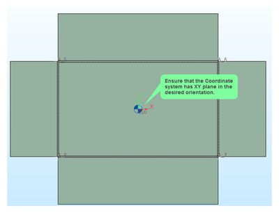

1. DXF from Model: Create an Instance of the Flat Pattern. Open the instance, Set Orientation Normal to the Flat Pattern and SaveAs DXF. Please refer to the Help section for creating an Instance for the Flat Pattern.
Ensure the following:
2. DXF from the Drawing:
To Automate, Create a Template file for the Sheetmetal Part. Use the Template to create the Sheetmetal Drawings. Template Files can be automated to show All the dimensions neatly arranged too. One may have a separate Template File for 1:1 Drawings of Flat Pattern without any format, specifically for export (SaveAs...) to DXF file.
