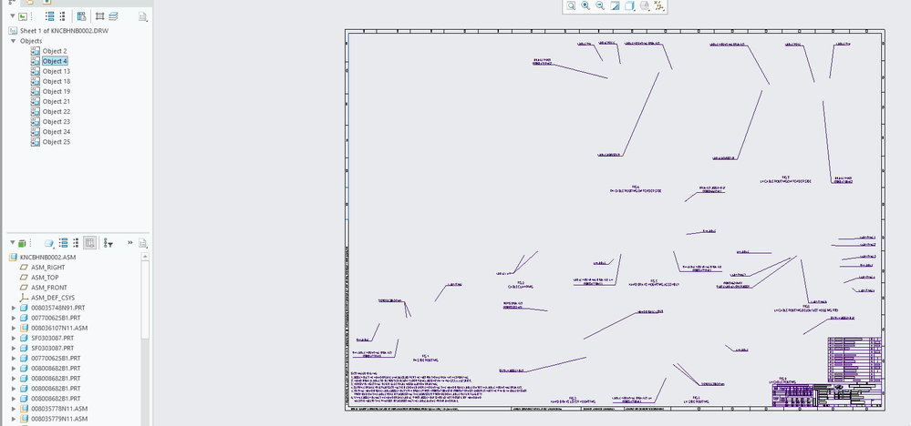

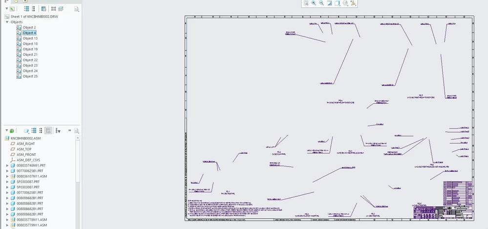

In teamcenter creo drawing is imported image is getting missed
Shubham_K_Rajak
It was saved in teamcenter. While opening from teamcenter image is not visible only dimension is visible. Imported Image issue.png

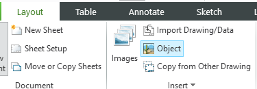

Import the images as "object", save to TC, and then check.
