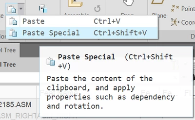

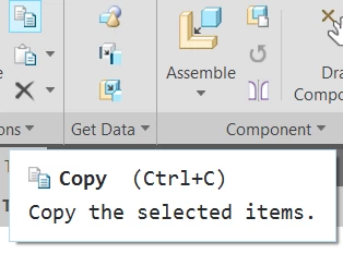

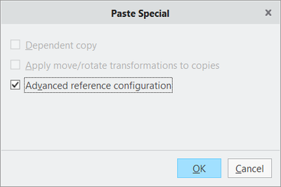

The workflow I use to duplicate groups of components from one assembly to another is
1) activate the source assembly and select the components and/or groups of components
2) copy
3) activate the target assembly and paste-special
4) check this box
5) OK, select the new references; you should not be required to re-specify the constraints between components in the copied group

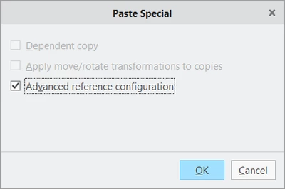

2) copy
4) check this box

After making the parts that I wanted to copy into an assembly, I was able to set the constraints to better suit they insertion in the new assembly. Thanks for showing me how to do this. It will save me a lot of time.
