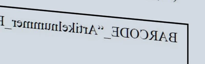

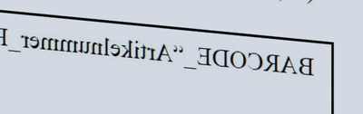

Hello.
Anyone knows why the button of edit decals are not available?
Inside my model, the decal is being mirrored and I can't edit to solve the problem.
Since it is an old part, I can't change the surface normal direction.

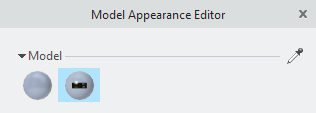

Sorry, its been a while and I gave you bad advice. Here is the correct information:
1. Click on appearances, and edit the appearance that contains the decal.
2. Click on the eye dropper
3. Select the surface that the appearance is applied to. After that, the dialog below will show up and then you can flip the decal as required:
VR_9713318
(To:Chris3)
Hello, Chris.
Makes sense now, the "eye dropper" to edit only one area of the decal, not the decal itself.
It worked perfectly.
Thanks a lot!
