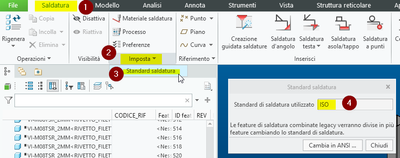

I'm starting to study the creo welding module.
I have a question. Is it possible to change the welding standard from ANSI to ISO in a model?
I've done several searches in the guide and on the internet but I haven't found a solution.
- First attempt: If I change it from the welding module preferences menu, the change does not take place.
- Second attempt: It seems that the "weld_ui_standard" config option only affects new models.
- Third attempt: The "weld_symbol_standard" option in the drawing options has no effect...
Can anyone help me?
Thank you.
P.S. I use Creo 9.0.2.0.

I found the solution:
just use the "Welding standard" command present in the welding interface in the "Setup" menu.
