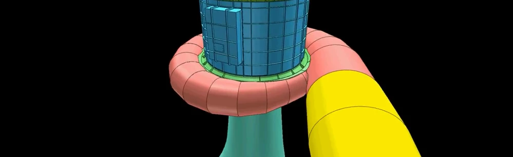

For about two weeks I am trying to make this for my project-
I have tried Sweep, sweep blend, boundary blend and other approaches.
But result is not satisfactory.
How can I do it?
Solved! Go to Solution.
1. I didn't remove any section, I did something similar to that shown in your second sketch. I made a solid spiral, not a surface.
2. If your spiral was a solid it would have a flat face. You could use that face to extrude a cylinder normal to the face. This means there will be a small cusp between the cylindrical feature and the spiral (no tangency).
3. I made everything solid and created a shell feature afterwards.
4. I don't know how to answer that.
5. The intersecting cylinder is simply sketched on the plane that is perpendicular to the axis of the spiral and extruded in both directions. It was created as a solid before the shell feature. Rounds were added at the end.
The model I created was put together very quickly and likely not the best solution.
Simple, use a sweep with 2 guide curves, make sure the variable section option is set, the section will be a circle, and make sure you constrain the 2 quadrants 180deg apart to both of the trajectories "reference".
The trajectory curves can be sketched or curves via equation, or use a single curve and make the diameter a function of trajpar, or there are a couple other ways....
I'll name that tune with one guide curve 🙂
Frank's right. Sweep with the VSS option... an origin curve for one end and a guide curve for the outer periphery. Sweep a variable circle/shape using both references.
Based on the suggestion provided by @Patriot_1776, using curves defined by equation in this case.

Yup! As mentioned, there are several ways. You can use a single trajectory as the guide, and use trajpar at the section level if you you want a straight linear change in diameter, or......do other things.....
I used equations in this case to get a quick model approximating the shape of features shown in the original screenshot.

1- How did you remove section from here? for spiral guide path it is intersecting.
2-How did you bring penstock out straight? I am using spiral trajectory. So it is not straight. Spiral is drawn using equation. To get straight portion out of spiral what shuld I do?
3-Did you use extrude remove material to make hole?
4-Also what's wrong with this? edge is not vertical it is different file with ellipse at one end..
5-What is technique for the perfect intersecting cylinder?
Thanks for reply
