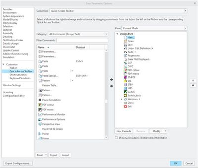

I have creo 7 installed in my system. In it i am missing a set of icons in the quick access toolbar which is regularly needed for me. All my colleagues have those. i tried copying there confi.pro and other folders but nothing seemed to work. These are the icons that i need. Can anyone help?

I am guessing that some of those in the list on the right-hand side are mapkeys that are mapped to icons for use in the UI. This explains why you are not able to find them in the GUI.
Are any of those commands found in the list of mapkeys in a Creo session that has the desired UI? You can find the mapkeys using:
File > Options > Environment > Mapkeys Settings

These are the commands that i require.

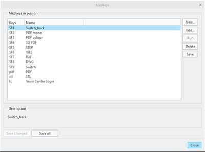

Yes these are found in the mapkey settings in my colleagues. how do i get it to mine?

These mapkeys are found in my system as well. How do i make it appear at the quick access toolbar?

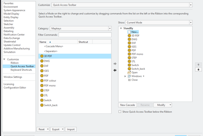

Thank you so much for your help. i was able to find the mapkeys but the icons are all smileys. Could you please help fix that?
Hi
Thank you so much for your help. I have now got the mapkeys to my toolbar with desired icons. i copied the icons from my colleagues system and pasted in mine.it was a big help from you guys. Thanks again.
