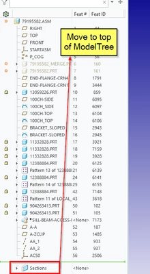

In Creo 10 Is it possible to move the location of the Section to the Top of the ModelTree or even attached this to the Insert Here line.  Is there a setting controlling this location.

No, the sections are always placed after the features in the model tree.
Sections—Dedicated container for section features, located at the end of the feature list.
AFAIK there is no option to modify this in the tree.
