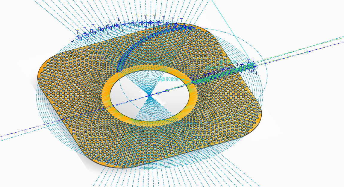

Nest smoke alarm: How to create the "fibonacci-like" hole-pattern
I just came across this Nest smoke alarm, and got curious about the pattern on the front: https://nest.com/blog/2013/10/08/meet-the-nest-protect-smoke-and-co-alarm/
Is it possible to somehow through one or more pattern features to create something like on the attached picture? I can't crack it myself. Help is appreciated
https://d2pupd7a6asjpt.cloudfront.net/blog/images/2013-10-08/nest_protect_smoke_co_alarm.jpg

Interesting patterns came up when trying to do this without the reference. For the most part, I got the jest of how to make sure it could be mirrored. I used the arc to get a good pattern and the linear pattern with a "twist" for hole sizing and extrusion.
Full version of Creo 2.0 attached (minus the underlay image so it doesn't mess anyone up).

This can be done with a sketch and patterned.
It looks like it follows a simple arc increasing diameters.
You can just 2 guide arcs and make the holes tangent.

My mind was stuck on the fill pattern, but I can see how it is possible with a sketch and a pattern around the center axis. I'll give it a try.
Thanks.
Quick and dirty test:
It needs some adjustment to look more like the pattern on the nest, but it's definitly possible. Thanks for the help.

Maybe:
pattern1:Arc with holes increasing in size as they go outward
pattern2:revolve pattern 1

Its not fibronacci... more like spirograph with control of a common web thickness.
It wouldn't be hard to duplicate by using the image as an underlay and finding the right guide arcs.
