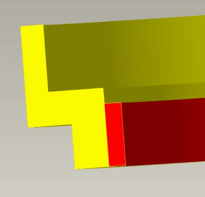

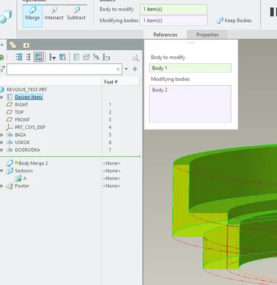

In my simple part when I add just new revolve, as result the feature will create new body instead the same body and to have it as normally was just additional geometry in the same part I must add boolean operation feature to obtain the single part as it was previously.

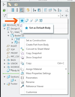

There was in my part Body 2 set as active (don't know why? perhaps due to history of the file):
So, under right mouse over Body 1:
You can set Body 1 as Active and viola!
Now this yellow star appears on Body 1 😉

I just jumped into Body Option and pointed Body 1 there and result was as I used to have, but maybe the bug here is that without ativating the checkbox "Create new body" result was not merge to previous geometry, but a new second body instead...

Thanks to Oualim for teaching me 😉

of course star is blue here 😁
