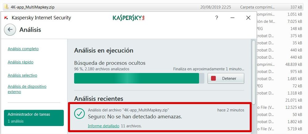

Hi BPO,

Here is how the virus attack took place:
I downloaded the file from the link that was shown for obtaining the RLC utility, named:
4K-app_Repeat-Last-Command.zip
But the proper RLC files were not contained in the link. So I contacted the author and was (privately) directed to download the zip file named:
When I installed it and attempted to run it, it did not function, but immediately my antivirus software reported the Trojan virus. Soon I received an extortion threat by way of email, with proof that personal password had been compromised already, which suggests that the Trojan virus had already done its sinister work.
Did you install the utility, and does the RLC utility work as described?
BPO
(To:Trebla)
Correction to my last correspondence; it should read:
4K-app_MultiMapkey.zip
When I installed it and attempted to run it, it did not function, but immediately my antivirus software reported the Trojan virus. Soon I received an extortion threat by way of email, containing proof that personal Windows password had been compromised, which suggests that the Trojan virus had already done its sinister work.
Why is the utility found at the link named 4K-app_MultiMapkey.zip? That is a misleading title and after all, does not contain files that appear related to the utility.
Or did you actually install the utility, and does the RLC utility work as described?
