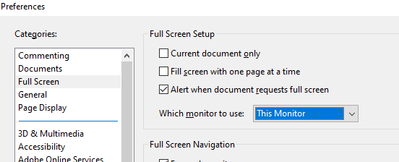

Not necessarily a Creo issue, but with Acrobat Reader, does any know how to have the .pdf always open on the secondary monitor?

In Full Screen, it has Which Monitor to use:
But the options are:
This Monitor
Best Color
Widest
Tallest
Biggest
Main.
If you drag the Preference page to the second monitor, This Monitor still is the first monitor.
