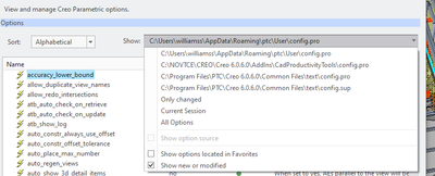

Do you have multiple config.pro files? Maybe you have one overwritting the session?
You can look at the SHOW drop down list to see all your configs that loaded. You can also look at the one called "current session" and see what is actually applied, this is helpful to see if a specific option is overwritten.
I just checked the "current session" as you recommended above (this was new for me!), and the save_texture_with_model option is set to the default value of "yes". I'm really not sure why I had to turn it to no and then yes. It looks like there are multiple config files on my computer, but there is just a default file and then a local file that I update my config options to. Maybe I had to add the option to my local config file?
The config.pro files load in a specific order.
The one in the text folder is first, then the one in "start in" folder (initial working directory, this will be different folder on yours), so if you have the same setting in both, the one that loads last wins.
Any option in the config.sup will "lock" that setting and no other config.pro can change those.
So adding that option to your local config in your start in folder is the likely your correct path.
