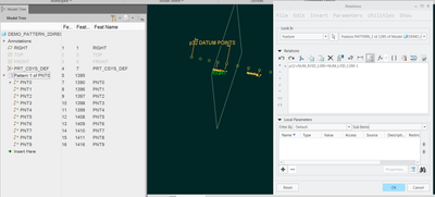

This pattern is possible if you use dimensional pattern and relations:
In the example above, the pattern is controlled by changing the parameters of feature "PNT0"
Feature relation:

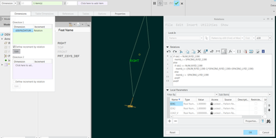

Pattern definition and relation:
Note: this is probably not easy to understand for (novice) end-users.
The parameters and the feature relation could have been defined at part level.
But the pattern relation has to be buried inside the pattern definition.
