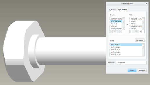

Is there a way to create an assembly of all (or certain) instances which are in a family table of a part?
For example:
1. I do have a part with a family table of all different bolts in (M8x20, M8x25, M8x30,...)
2. I create an assembly with the generic of this "family tabe"-part in the default position
3. I will make a pattern of this generic part, but not only the position of this bolt will change but also the instance
Bolt assembly.pngIs there maibe a way by doing this with a "table pattern" or in combination with a parameter which is in the part?
If this is possible, this will help us a lot!

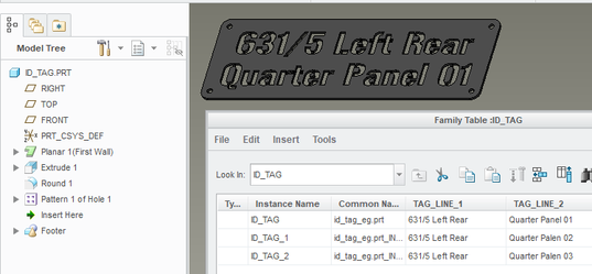

ID plates are just steel plates with an ID number in. Just a kind of "license-plate" for parts.
This is what we like to do:
Just one part with a family table. In this family table all parts do have the same dimensions, only the parameters of the "ID" will change.

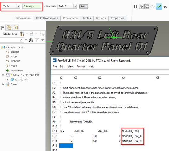

In that case, I would use a Pattern Table to create the assembly of all your Family Table items.
Create a new assembly
Assemble the first instance of your ID tag (not as default but with offset constraints to your assembly origin)
Select your ID tag --> Pattern, and select Table. Select the offset dimensions, then click edit the contents of your Pattern Table.
You 'll see an "Pro/TABLE" dialog.
At row 11, you'll see:
!idx         dXXX      dYYY    Model(name_of_part)
You must complete this "list" with all your instances.

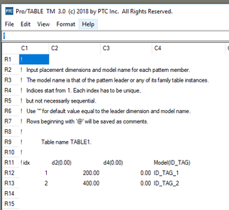

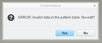

I've tried this:
1. First I've made a family table in the part:
2. And then I've made an assembly with a Pattern Table:
This is the result:
The problem is that you only can add the dimensions and not the instances of the family table:
in the third column ... enter instance name, only.
Martin Hanák
Like @MartinHanak said, you need to enter the instance name in that last column.
So only ID_TAG_1 and ID_TAG_2

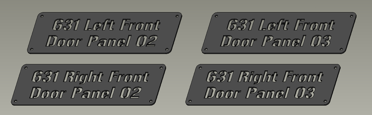

Hi Guys,
this works perfect!
I've created the table-pattern like this:
And this is the result:
Exactly what I wanted!
Thanks a lot guys.

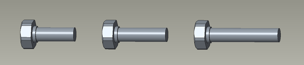

I guess you have to generate trail file and run it to assemble family table instances.
See my attached data created in CR2 M070.
1.] I prepared bolt.prt containing 3 family table instances
2.] I prepared bolt.txt trail file containing 3 blocks for assembling 3 family table instances
3.] TEST: Launch Creo 2.0, create new empty assembly, play trail file - you will get result shown on bolt.png picture
Note: To prepare trail file for big family tables, user can create some script which gets a list of instances and generates trail file for assembling all of them.
