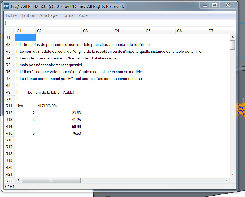

Hi all,
I just made a pattern with a table, and I'm a bit surprised, Pro/TABLE only takes 2 digits and rounds the values I entered.
For example, in the table below I wrote 23.625 and it took 23.63 !! Any idea ?
dimension d1719 has 2 decimal places set in its properties. In model show the dimension, select it, press right mouse button, click Properties and set 3 decimal places in dialog box. Regenerate. Then you will see 3 decimal places values in Pro/TABLE editor.
MH
Martin Hanák
Thanks Martin, this is logical but didn't think about it.
