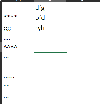

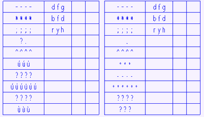

When trying to import spreadsheet from excel to creo drawing, creo replaces rows with dash dots as you can  see in picture. I saved excel file as CSV MS DOS
9 REPLIES 9
I don't know what character you are referring to as "dash dots" in your excel file, but my guess is that it is a character not recognized by Creo.
Try saving it as a CSV comma delimited.  I obtained different results for a variety of characters.

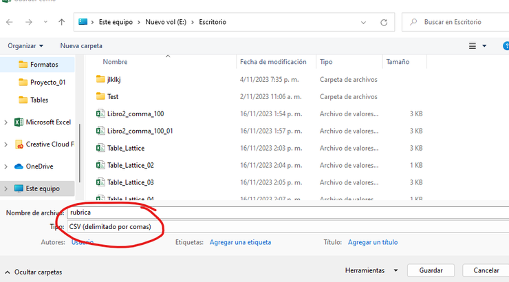

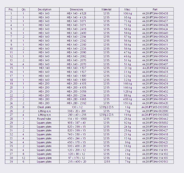

i have a similar problem, creo do not recognize the columns from excel, crating just a big list with semicolon separator just          like the pictureCreo_Excel.png
What format are you saving it as to import into Creo?
CSV Comma Delimited should work correctly.

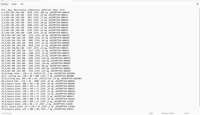

What does it look like if you open it in notepad?
Comma.pngjust like this, with semicolon, i tried to replace all the semicolon with colon and it do not recognise the filenotepad.png

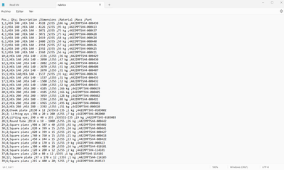

nevermind, just solved, exported it as .csv and opened in notepad, replaced all the semi colon with comma from the editor tab and saved it as whatever name.csv solved.png
TomU
(To:ptc-4658280)
Looks like you need to adjust Excel's delimiter.
https://www.ablebits.com/office-addins-blog/change-excel-csv-delimiter/
