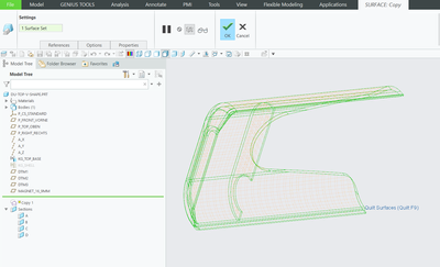

Can anyone please answer how to access the solid model /edit definition of this Quilt surface?

The geometry shown in your picture is a child of one or both of the copy geometry features seen in the model tree. Without getting the models that are the source of the copy geometry you are not going to be able to explicitly edit the parametric elements.
This is essentially the same question you posted in your last thread.
Step 1: Identify the parent (source) objects for both copy geometry features.
Step 2: Open the source files and determine if they are the top-level object, if not get the next higher level until you are at the top level.
Step 3: Modify the elements needed to update the design geometry.
Three simple steps but in practice this can be a very difficult problem. Without access to the models, it is hard to determine what is needed,
