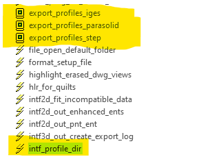

I would like to automatically have the def_profile.dep_step loaded when starting the program versus having to remember the first time saving a .stp file. Is there a way that this can be loaded in the config.pro?

Are you looking for this config:  export_profiles_step C:\*\*\def_profile.dep_step

Here are the config options.  We also export parasolid and iges files so we have them mapped also.

After testing, that is what I was looking for.
Where the "C:\*\*\" is the path to the place where you saved the .stp profile out.
