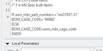

I did this in Creo+ (13.1).  Here is what I got to work:
IF asm_mbr_part_number=="12345"
my_cage_code="96906"
ELSE
my_cage_code=asm_mbr_cage_code
ENDIF
I did step 2 above to create my_cage_code in the table
BenLoosli
(To:kdirth)
BOM_CAGE_CODE="96906"
ELSE
BOM_CAGE_CODE=asm_mbr_cage_code
ENDIF

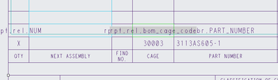

The one additional step is to use &rpt.rel.bom_cage_code in your cell in the BOM.

What am I doing wrong?
BenLoosli
(To:WF_10971917)
Is BOM_CAGE_CODE in your Local Parameters list as a string.
