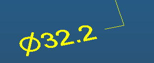

Hi everyone,
I’m working with the team in charge to move to MBE, and I’ve run into a challenge I hope someone can help with.
I’m trying to remove the general linear tolerances that appear on every part (see attachment 1). I experimented with setting the "tol_Display" option to "no", which does remove the general tolerances, but unfortunately, it also hides all the local tolerances on features of size (see attachment 2 and 3).
Has anyone found a way to remove just the general linear tolerances while keeping the local ones visible?
I’ve attached a reference image to show what I’m working with. Any tips, workarounds, or settings I might have missed would be greatly appreciated!

The tol_display config option has three possible settings: no, yes, and no_tol_tables. You might want to try the last one.
I did, but the result it's the same, both tolerances, local and general, are gone.
Van_AG
(To:EnriqueNunez)
Set config option tolerance_standard to iso
For existing models and model templates set
File > Prepare > Model Properties > Tolerancing Standard > Standard > ISO/DIN
I tried the option you mentioned, and it successfully achieves the intended result (see attachment). However, since we are currently working on the project to transition our company to a Model-Based Enterprise (MBE), we primarily use models based on the ASME standard, though we also incorporate models aligned with ISO GPS. As part of this initiative, it is a requirement to manage the dimensioning and tolerancing system also represented within the 3D model. Therefore, this solution would conflict with that requirement.

Displaying general tolerances is part of the ASME standard. Not displaying them is fighting the standard. They disappear when switching to ISO because general tolerances are not part of the standard.
Have to have separate start parts, dtls, etc setup to manage each type.
You can set ISO to hide the general tolerances and manually set many things back to fit ASME but some stuff will not be right. That is how it will be if you want to go against/modify the standard.

So... you want the model to use the ASME standard but don't want to see that tolerance per decimal-places table in that graphics area?
That's not possible, AFAIK, except perhaps with this hack:
Set the "Secondary Highlight" color to be the same as "Background" color:
You would need to maintain two different configuration files for .pro and .dtl.
e.g. asme_config.pro ---> which calls asme_config.dtl
iso_config.pro ---> which calls iso_config.dtl
using the .pro setting...
drawing_setup_file --> asme_config.dtl or iso_config.dtl
format_setup_file --> asme_config.dtl or iso_config.dtl

File > Prepare > [Detailing Section] Detail Options - CHANGE:
default_tolerance_mode: nominal
This will set the default tolerance to nominal, so when you place the dimensions, they will have no tolerance by default:
Only after you've changed it to, say plus-minus, the tolerance will appear. You can then select your tolerance table or set manual tolerance values:
Hope this is what you are looking for. If so, you can apply this setting in your speciffic template file - you can then select if for specific purpose only.
From the dimensions, I guess that you are using a Metric system for Dimensioning. If so, are you using ISO standards for General Tolerances? The general tolerances shown in pic [1] appears only when set to ANSI Standard.
You need to set the Tolerance Standard to ISO for it to disappear. Refer picture below.
