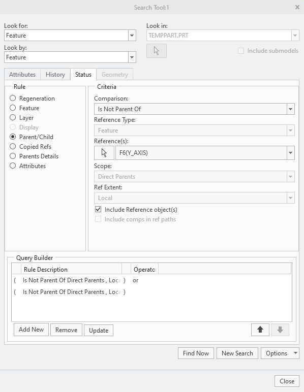

Chris3
(To:JiffiPop)
You use the find tool to find all of the features that have the parent child relationships that you don't want. Use a the build query to add all of the features that you want to keep and then find all of the parents that are not part of those children features.

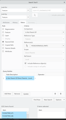

JiffiPop
(To:Chris3)
Hi Chris, thanks for your response. It seems like when I select 'Is Not Parent Of' the features that make up a part, it selects all of the features in the design tree. I also can't see the entire window and cannot resize it to be small enough when I have 'Build Query' open. I will have to keep poking around and get back to you, but at a glance this is not doing exactly what I am looking for.

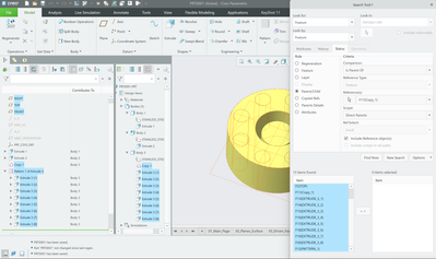

JiffiPop
(To:Chris3)
Please see the attached part. In short, I think the search tool will not do exactly what I want. Here's why:
In the attached part, I have 3 bodies: Body 1 is independent, Body 2 is independent, and Body 3 is a copy of Body 2 that is modified with an extrude pattern.
If you use the search tool as you mentioned, and you search for features that are 'Is Parent Of' Body 3 features, it doesn't select Body 2! But how is this possible, if Body 3 is created by copying Body 2??? Because of this, I think the Search Tool may not be the solution.
Perhaps I am using it wrong, though?
Chris3
(To:JiffiPop)
To be honest I have never attempted what you are trying to do. As far as I can see there is no way to filter on bodies using the find tool so it may not be possible to do what you want. I know you have 1000s of features, but can you just expand all of the features under a single body by clicking the show more features button under the body and then shift select all of the features for that body?
