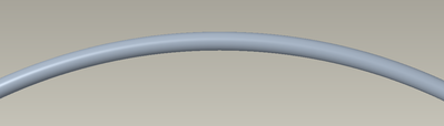

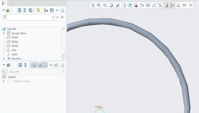

Hello guys.
I'm sorry to ask such a dumb question, but I'm absolutely stumped on it. And it's REALLY dumb.
The attached model is a simple revolve of a 25 mm wide tire profile with a 700 mm radius out to the rim. (Yes, it's not realistic, but this problem happens even if I reduce the radius to 400 or 50 or whatever.)
The revolve feature ends up all chunky, instead of smooth. If I reduce the radius to 50 mm, the inside of the feature ends up all chunky instead.
I have changed the model accuracy both up and down and nothing ever changes.
Thank you for advice on how to get back to the regular, smooth revolves that I know and love.

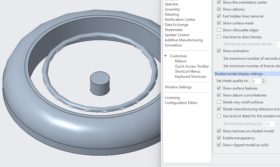

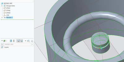

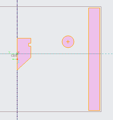

OK, I think I see what's happening. Tourus-shaped revolves have this, but cylinder shaped ones do not. With this sketch:
I get this revolve, showing both the nice smooth edges I was expected, and the blocky edge (on the torus in the middle).
this is definitely shading quality related (set to 1, 5 and 20 in the screenshots)
Why the shading quality setting only seems to apply to non ruled surface types, I do not know.

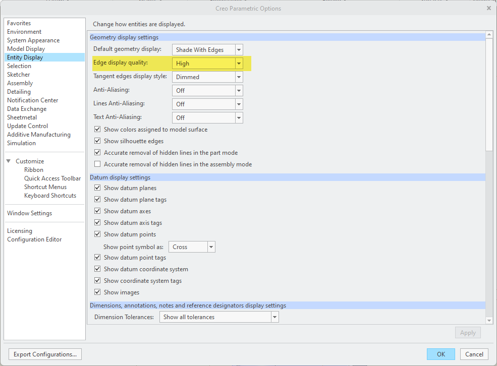

Try setting the edge display to high or very high and report back on the results of doing this.
File->Options
Involute Development, LLC
Consulting Engineers
JA_10341562
(To:tbraxton)
That did not fix it. (Mine was on medium.)

I'm using Creo 9 and I built myself a quick torus 8 inch ring diameter, 0.50 inch diameter swept profile.
Using the default for File -> Appearance -> Model Display -> Shade Quality, it looked pretty chunky. If I increase the value of that setting to the maximum (50) it looks much smoother and stylish. I also have Edge display quality set to Very High, but I don't think that affects the shading.

700mm radius with 25 mm diameter xsec in Creo 7 with shade quality at 30 looks pretty smooth.

Sorry to say, but that looks like a normal representation of a revolved circle in Creo.  It is only a rendering aberration.
