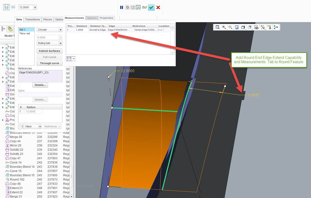

Please use the link below to vote on the following idea.
Round Feature Enhancement - Allow to Extend Ends x Distance on Both Ends When Round Create as Surface Type
Please add the ability when creating a surface round to extend the end surfaces x distance each on each side of the round.
This would eliminate the need for 2 extend features in the model tree and reduce time to round corners where pro/e not able to produce round transitions.
Don Anderson
2 REPLIES 2
I take it the Extend Surfaces button isn't giving you what you want?
(I know you probably already tried it but at the same time I've seen plenty of users miss the obvious things. Including myself!)
Don,
You are correct, the Extend Surfaces button was not giving me the correct surface. In my cases it stops short or will not create the round as a surface or solid.
