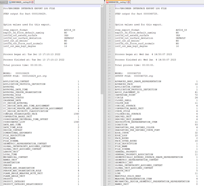

Has anyone come across the issue of a STEP file being a facet model?
Have you seen any log file like the one on the left?

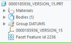

I've had a few different people on Creo 7.0.4.0 and Agile PLM MCAD 3.6.3 inadvertently create STEP files that are facet models.
They did create STLs of the models at one point.
The STEP log file even shows the facet items
I'm unable to reproduce this issue, or even a log file that looks the same.
Import of STEP file:
This is the facet STEP on left and regular STEP on right. Notice all the PLM-type attributes, like APPROVAL (yes these are from different PRTs)

I've never seen that.  Ever.  Perhaps they made a mistake and actually exported a .stl file and THOUGHT they exported a .stp?  OR, maybe they FUBAR'd some export settings in the output so badly that his is what happened?  Dunno.  Never even HEARD of something like this.

Yes, this is possible if your source model is a facet model to start with.
Solid part -> STL -> reimport as part -> save as STEP
I guess this was done by mistake.

Yes, that is a way to create a Facet STEP file. Unfortunately, this is not what the user performed because the model name was already in use as the native model. So the STEP would have been prt0001.stp

As far as I know, STEP is pretty much just a "pass through" conversion. It writes out what it gets in. If the log is showing facets being written, it means it must have been processing them from the input file. The only thing I've seen that might let you output geometry "types" that aren't in the original file is if you set "Export solids and quilts as" to one of its available options. Their is an option to Include Facets, but that just tells the exporter whether to include any such geometry that is already in the model. I tried to get a model to be output as facets by playing with the options, but to no avail.

What is weird is even if I do create a PRT from an imported STL, then save as STEP, I cannot create a log file that matches the log file the Agile MCAD integration made.
