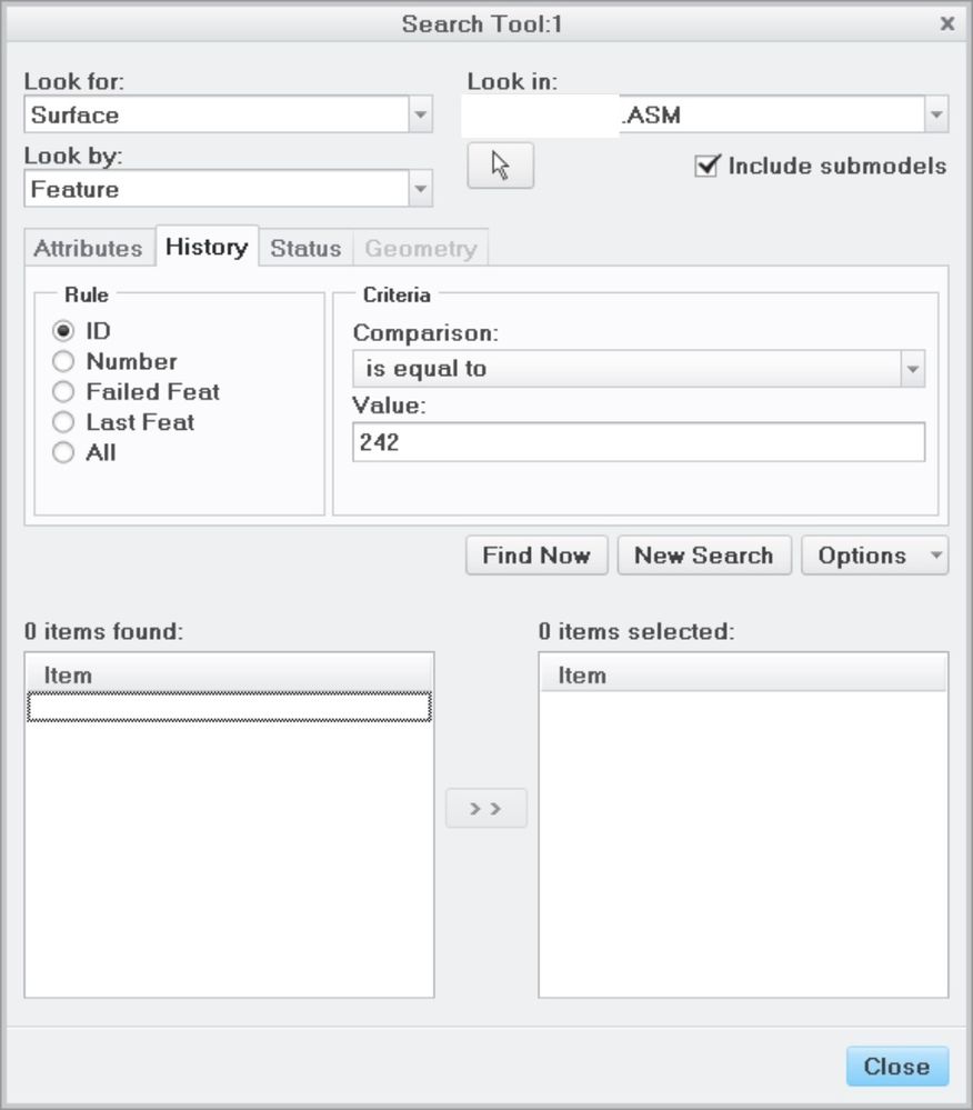

I did a shallow assembly cut (.002") using text of our "PART_MARKING" parameter to mark the part.  As I usually do at the part level, I tried to use the search tool to find all the "surfaces" of that "feature" or "feature id" so I could easily change the color of all the surfaces to black to make the marking visible.  Imagine my surprise when it completely failed to find any of the surfaces, whether I tried by "feature" or "feature id".  Has anyone else noticed this bug?  Is there a Pro/WORKAROUND?

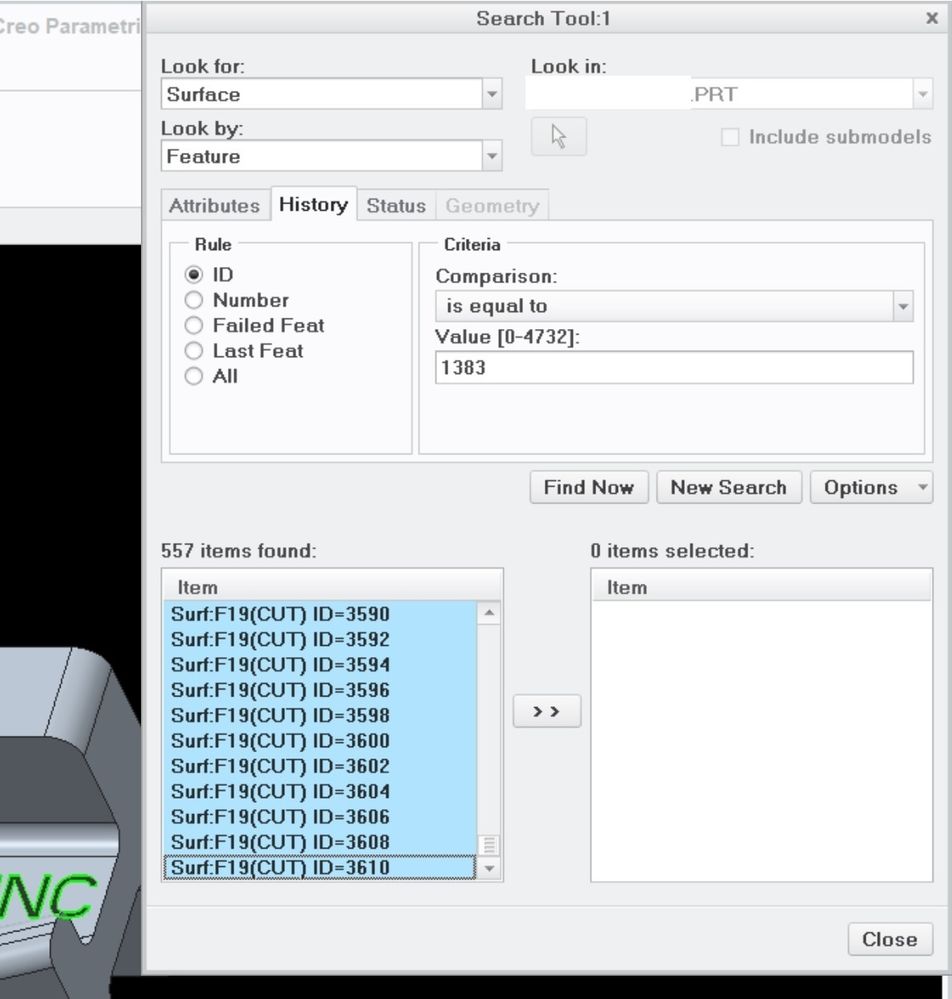

Hey Martin.  I tried doing "Surface" by "Feature", "Name" or "Feature ID" as I always do, and it works just fine in part mode, but absolutely will not for an assembly cut.
Part cut:
Assembly cut:
I'm going to call that a bug.

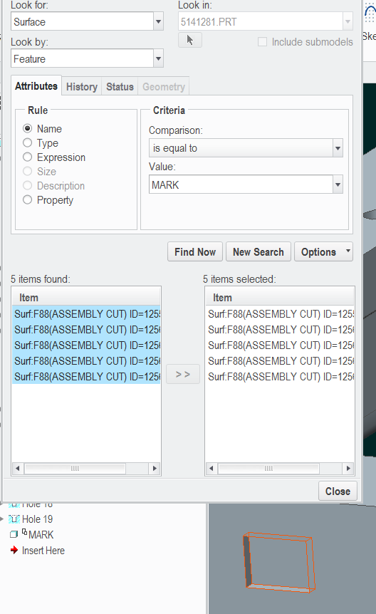

Well, it works if you make the assembly cut a part-level feature:
(I renamed the assembly cut feature "MARK"; also note that this search was done with the cut part active - but should work from the assembly context).

Yeah, I don't disagree.  It should work, and you have shown it does not.  I was just pointing out a clue as to why it does not work - namely, that the surfaces made by the assembly cut feature don't actually "belong" to the said assembly level feature, but instead they belong to a (hidden) part level feature that is created by the system.
Even if you didn't make the assembly cut visible on the part level, you can still see it in the assembly's model tree (expand the intersected model and you'll see something like "Assembly Cut id 1107296328" ).  And you can search for surfaces by that "hidden" feature (for example, by it's feature number, ID - or by name, if you rename it first).
