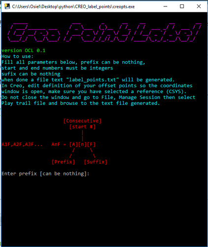

Creo point relabel
this script will generate a trail file wich when run will rename all labels in offset point table (must be open). I made a executable file for those who do not know anything of python.
https://github.com/Osiel-Gaona/creo_point_relabel

what I did is just copy the code of the trail file and figured out what part of the code corresponded to the label and then in python I used the code of the trail file and generate a new trail file with the new data.
