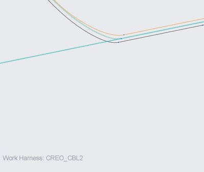

1. Routed cable 2 first.
-Created network and routed the two wires.
  • Image cbl2_pic1.jpg shows the zero thickness (center line) cable and network. Wires are the orange and black lines and the network is the dashed line.

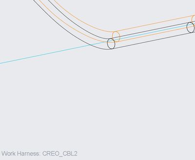

  • Image cbl2_pic2.jpg show the same with thick cables. You can't see the network when thick cables is selected. The wires are side by side (not together).

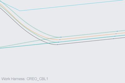

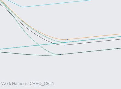

2. Edited the cable 1 next. First I shared network from cable 2.
  • Image cbl1_pic1.jpg shows the shared network as a separate entity (even though it is shared with cable 2). Wire is not routed yet.

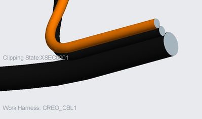

  • When I actually routed the cable 1 wire (USB) the shared network moved below cable2 with the routed usb wire(cbl1_pic2.jpg).
  • End result looked as shown on cbl1_pic3. All cables are in one line and not on top of each other.
At the end I was not able to route cables on top of another with this test and network sharing.
I was able to put the USB cable on top of the power wire when I drew a new network for the USB cable following the original network path that I made for the Cable 2.
