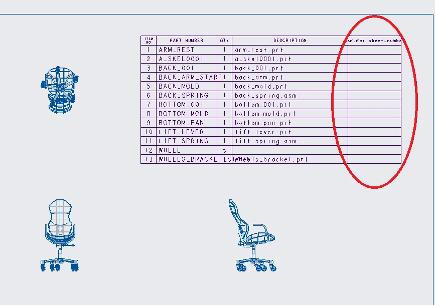

Hi
I created an assembly drawing with the part drawings in different sheets. Is possible to add a column in the BOM table that displays the sheet number associated with that part?

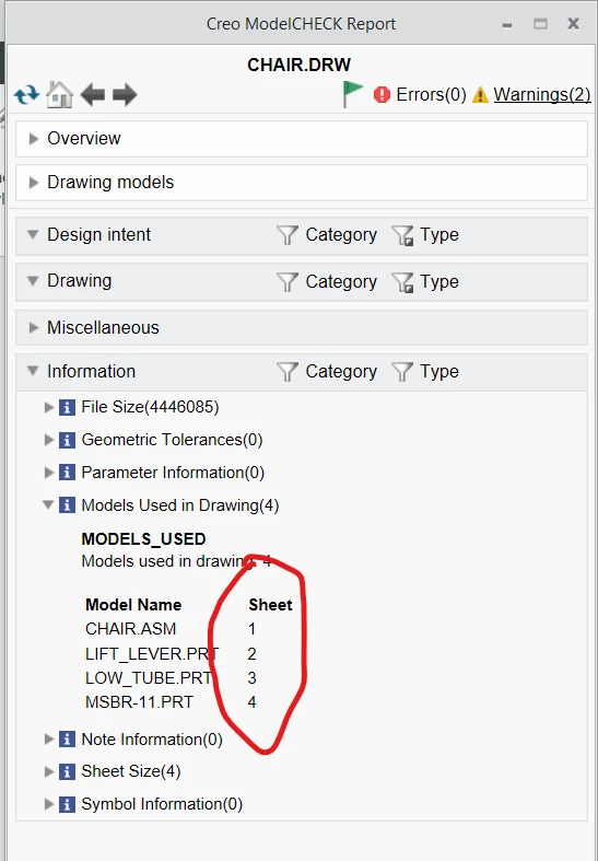

Also i noticed that the model-check report is showing the information exactly as i am looking for, but i wish it could be added in the BOM Table.
Best answer by Mahesh_Sharma
@Kishore_K
MODELS_USED in ModelCHECK is an information check and is not designed to create any parameters in the drawing or the models or repeat region tables. May be possible using some custom application by toolkit/Jlink etc....
