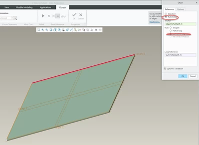

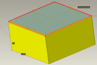

I am using Creo 7.0.8.0. In earlier versions of Creo, I remember being able to bend 4 walls of a simple sheetmetal box in one feature by control-clicking the 4 edges of the first planar feature. I can't seem to do this anymore. When I hold the ctrl key, there is no option to select additional edges. I have to create 4 separate flat-bend features to create a box. Am I missing something here? Thank you.

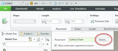

Flange feature, then "details", then select rule based, complete loop, you'll have one of the edges and the surface with all 4 sides

StephenW23-Emerald IIIAnswer
January 31, 2025
I'm on Creo 8, but I suppose its really close to the same.

The method shown by @StephenW is identical in Creo 7.0.12.0 to bend all four sides in a flange wall.

I am using Creo 7.   You have to use Flange and hold Shift to select adjacent edges or a surface to select a loop.

This method worked as well as Stephen's above. Thank you, kdirth.
