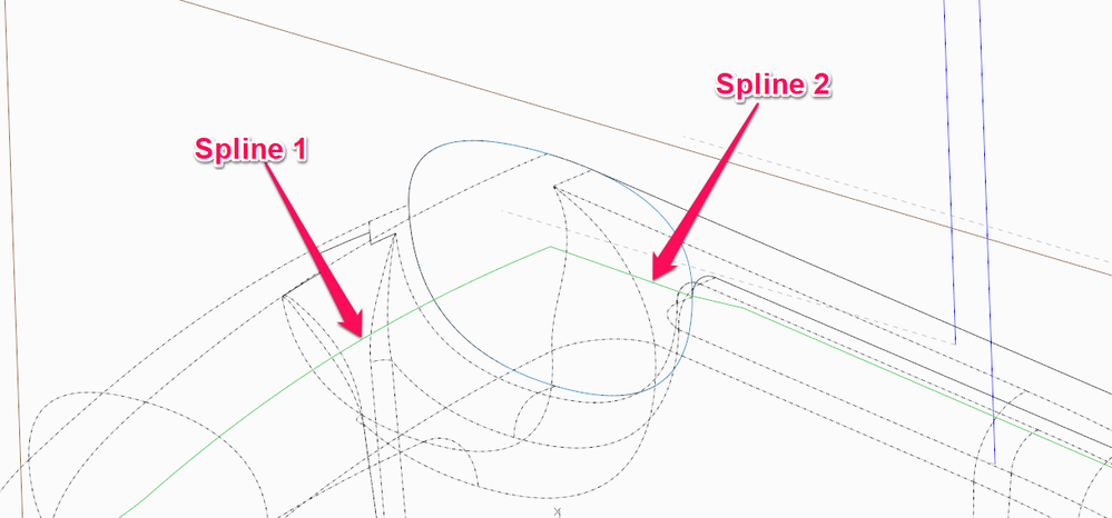

Hi Creoes,
I have a question how to create a surface using only 2 splines - one for shape and other for trajectory?
It is possible in other CADs but Creo.

using sweep options you can create geometry whose sections are not perpendicular to the trajectory.

I uploaded test model. Look at it.

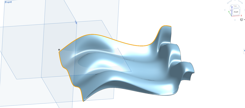

Another issue (for me) is, Sweep command forces to create the perpendicular section to the trajectory line/spline what gives a different result.
In SW/Onshape or different CADs, it is possible. Onshape below.
