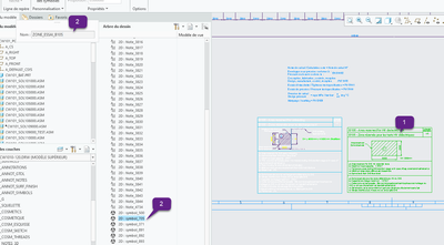

Hi all,
In CREO 7.0.2.0 or in CREO 8.0.5.0, we want to see the symbol name in the drawing tree.
In the following pic, you can see:
1 - the Symbol
2 - the symbol name
3 - the drawing tree (Creo 8 version)
I think the symbol name is saved somewhere, and I think it should be possible to extract it in order to make it appear in the drawing tree. I thought it was possible to save the drawing tree as drwtreetool.txt, but I couldn't find the file.
Could you help me to find the txt file, and how to view the symbol name in the drawing tree?

BenLoosli
(To:Dom_BOUCHARDY)
I do not think this is possible at this time. Same for table names, which I have asked for.
The system knows the information, but the programmers have not written the code to be useful in putting that information into the drawing tree.
Thanks.
Maybe in a future release?
Regards
At this time, I believed your only option is to manually rename the symbol.
If they do make a change to use the symbol name in the model tree, I would expect it to have a number appended to it to allow for multiple instances to be used (name_1, name_2, name_3....).
Thanks for the workaround.
It's not very satisfying, but we'll deal with it 🙂
