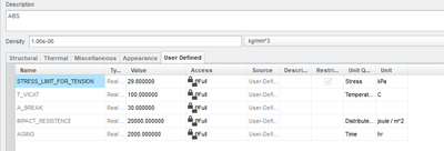

I have a problem: I use a material with user-defined parameters on a model; when I create the drawing, I want to insert a symbol that automatically includes the instructions for producing the component, and I would like the material parameters to be automatically inserted. How can I do this?

the material has user-defined parameters for example the on in the image below
then, when i realize the drawing i use a symbol to describe better how to produce the part and i want to use one of the parameter from material to substitute, for example, the value 200 in the image below
using ampersand doesn't work...

Based on the image of your above post, which is all text. I would consider using a note rather than a symbol to place this information on a drawing. You can store the note as a text file and import it to a drawing using the note from file function. If you use consistent parameter names in your models, then the note can use those parameters based on the active drawing model when you place it in a drawing.

Unfortunately screenshot is a part of entire symbol in which i have also sketched parts (triangle) and some area to be filled with drop down menu
so using simple text isn't suitable
