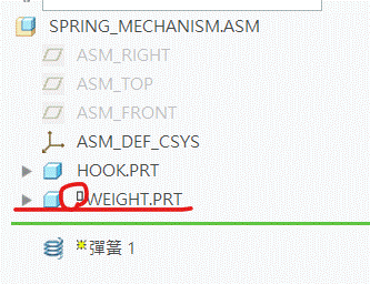

Hello Everyone,
I am trying to use spring from creo mechanism but unable to select the second point. Second point is circled with blue in attached image.
Please suggest.

Dear Shaikh Naushad
I found out why we cannot select the second point for the spring mechanism.
Your packaged component must be an assembly component that is not fully constrained.
Please find the attached image.  Thank you!
