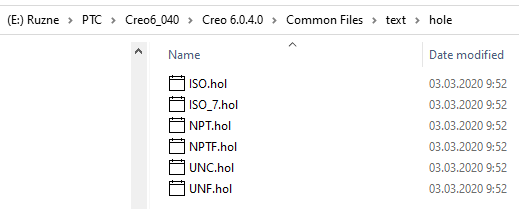

MartinHanak
(To:dcokin)
hole table files are file located in <CREO_LOADPOINT>\Creo 6.0.x.0\Common Files\text\hole directory, for example:
Martin Hanák
See https://support.ptc.com/help/creo/creo_pma/r6.0/usascii/index.html#page/part_modeling/part_modeling/part_nine_sub/Formatting_Thread_Notes.html help page.

Pettersson
(To:dcokin)
Sorry, I was using the wrong terminology. I meant "hole charts", not "hole tables". Martin has pointed you in the right direction. It won't change the existing notes, but if you set up your own hole chart which is a copy of the standard one but without the notes, that should stop users from creating new hole notes by default.
Another thing that might help: If you use "Show Model Annotations" you can show the hole notes as normal annotations. Then they behave just as any other annotation and can be hidden through "remove from state". heck, you can even select them and delete them, which will remove the hole note from the hole.
