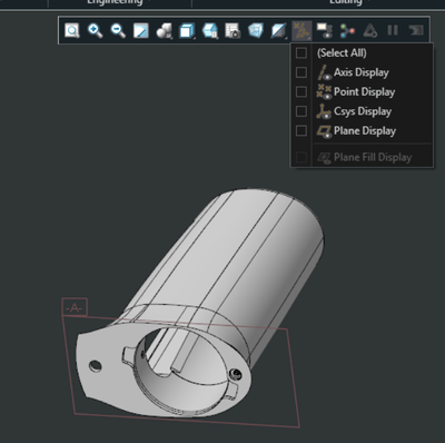

As can be seen in above screenshot, even though the "Plane Display" is turned off this plane is still visible. This is part from an assembly that I received from a colleague, and for that whole assembly as well when unticking everything in that dialogue box some planes are still visible.
I'm using Creo 9

Looks like a "set datum plane" from a legacy model.  I believe that such planes need to be put on a hidden layer to hide them, or in Creo 8 and above, you can set a configuration option:
hide_set_datum_plane_with_plane to yes so as to be able to use the plane display view toggle to hide them.
See this video
or this thread
for more info.
