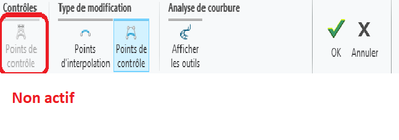

With Creo 8 and in spline modification, how to activate control points

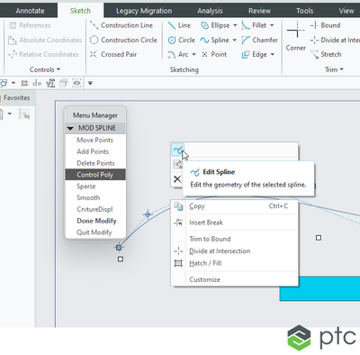

Hi
You are looking for the control points settings in drawing mode for splines.
Did you try and RMB the spline like below?
BrunoTHERY1-VisitorAuthorAnswer
August 30, 2022
August 30, 2022
close Point slide dialog box.
