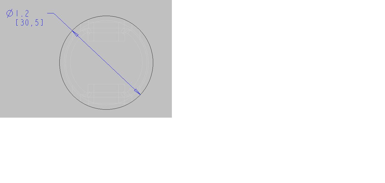

dual dimension shows comma instead of a decimal point?
rohit_rajan
why does the dual dimension show a comma instead of a decimal?
John.Pryal
(To:rohit_rajan)
try setting the dtl config option "decimal marker" to "period", it is probably set to the default "comma_for_metric_dual", which is why you see a comma.

thank you very much!
is it possible to get dual dim in creo 2.0 and also please tell mw the way to sout out the problem .
Check to see if the ASME standard does not specify a comma instead of a period first if the dwg is being checked to ASME.
